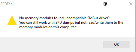

                      • I just downloaded SPDTool to check it out as a free alternative to Thaiphoon Burner (which works fine on my system). SPDTool opens and give me the error shown below. All I did was open the program and this message pops up. I can't read or write to my G.Skill DIMMs. No idea what the problem is. I guess I will stick with Thaiphoon Burner.
