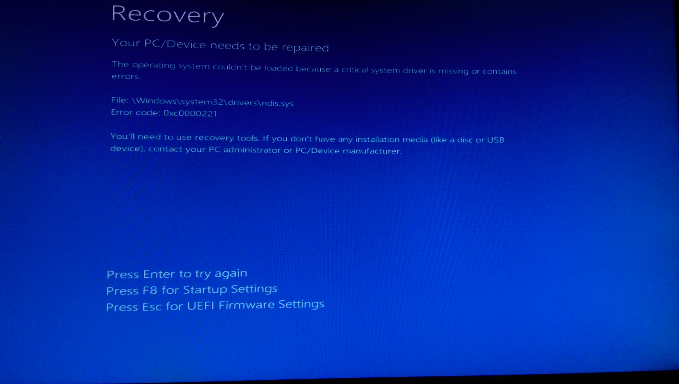

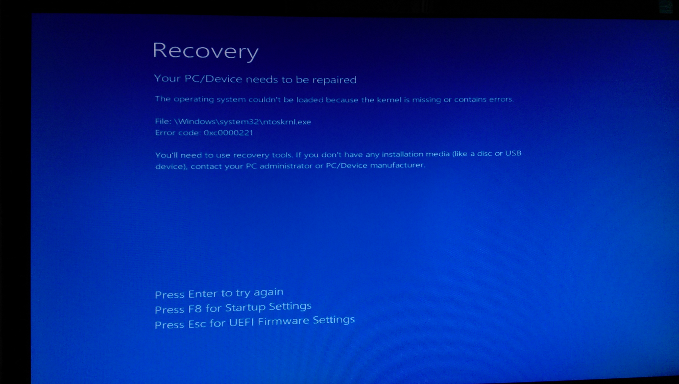

    First my PC was running only on 8GB(2x4gb) of the above mentioned ram, it worked perfectly on XMP Profile 1 settings 1866 (933mhz), after that i thought to upgrade the ram so I bought other 8GB of the same sticks(2x4gb) to have total of 16.
    The problem is that my pc won't boot windows 10 with XMP Profile 1 and 2 set blue screen errors saying contact the administrator. But it does boot when XMP Profile 1 and 2 are disabled.
    I even tried manualy to edit the timings but then the bios won't even start.
    What do you suggest ?

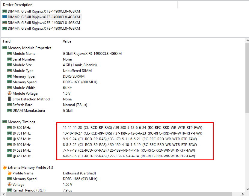

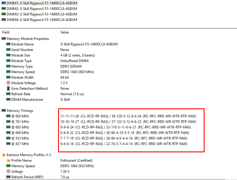

    If both kits were produced years apart, there might be differences in the secondary timings to allow for the change in ICs and/or IC density used on them. You can check that for yourself via Aida64 > Motherboard SPD and then compare the secondary XMP timings between the older and the newer modules.

      I have print screened the timings I'm not an expert but i do see some difference in the numbers, i tried to boot with two sticks with xmp profiler they work fine , but with four they can't boot se atachments :/
        The XMP timings are not in the screenshots, you have to scroll down a bit too see them. But from the standard profiles i can already see, that the newer kit probably uses higher density ICs and the XMPs between both kits will likely differ as well.

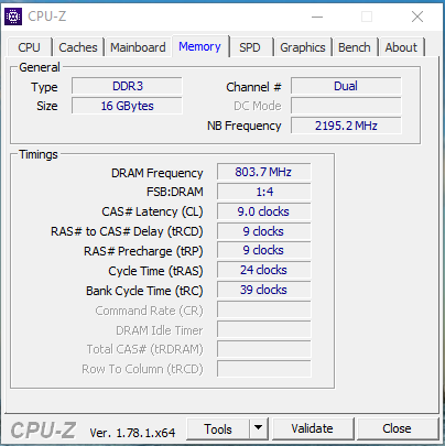

              The most i get for them to work is 11-11-11-28 1600(800mhz) on kit is dual channel the other is single i guess something with my motherboard..
                The latest timings i managed are 9-9-9-24!
