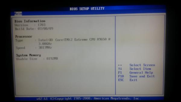

        So any 2 G.Skill modules work, just not 3 or 4?
        Can you send some pictures of BIOS with 2 installed?
          correct, and I have tested all possible combinations.
          Anything particular you want to see from my BIOS?
          Will take some pictures of what I assume is relevant for you.
            first batch of pictures. Hope they are readable.
              anything else you would need apart from the pictures above?
                Before I continue with any trial, pray and error I would really appreciate any guidance from support.
                Thanks in advance.
