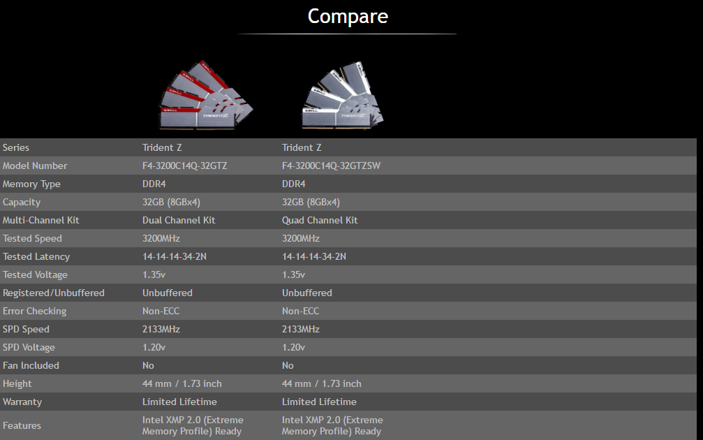

    On G.Skill's site under Trident Series, I can select 32 Gig (8 Gig X 4) Dual Channel or Quad Channel, 3200 MHz tested speed, 14-14-14-34-2N and get the following part numbers.
    Dual Channel - F4-3200C14Q-32GTZ
    Quad Channel - F4-3200C14Q-32GTZSW
    If I understand G.Skill's part numbering scheme, the SW at the end of the Quad Channel part number indicates the color scheme of the DIMMs and nothing more. Take that away and they are the same part number. If I select them and Compare, I see the attached image.
    The specs are exactly the same except one says Dual Channel and one says Quad Channel. So what is the difference between these 2 sets of Ram? They have the same part number except for the suffix that I am pretty sure just indicates color. They both are 8GB x 4 DIMM kits.

      Dual Channel is designed for Z170 chip set
      Quad Channel is designed for X99 chip set
      Take a look at the QVL list for compatible motherboards
        Yes I did look at the QVL for both of them and do see that, and that they are listed as Dual Channel or Quad Channel. But the part numbers are the same except the 2 suffix letters at the end which I thought just denoted the color scheme of the DIMMs. All of the specs listed and all published timings are identical. So the ONLY difference is that one is Dual Channel and the other is Quad Channel?

          There might be differences among the secondary timings or in general in the way the SPD is programmed to optimize it for one platform or another (other than just a different number of modules per channel).
            Yes there may be differences at those levels. The G.Skill specs do not go into that level of detail so there is really no way to tell unless sets of each are physically in hand. Perhaps a G.Skill rep will chime in again with more detailed information.
            Thanks!
              XMP is designed for the specific platform. A quad channel CPU vs. dual channel requires different settings/Voltages. For this reason it is imperative to check G.Skill QVL list and which motherboards are fully certified. These are extreme performance memory kits so it is not as simple as only matching a frequency number for compatibility. The only specs that can be considered universally compatible is DDR4-2133 CL15 1.20V.

                Thanks for your response. It makes sense.I guess those last 2 letters in the part number for G.Skill F4-3200C14Q-32GTZSW really don't just denote the color scheme of the DIMMs. Since that is the only difference in the two part numbers, it must also denote Quad Channel verses Dual Channel.
