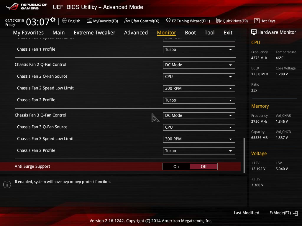

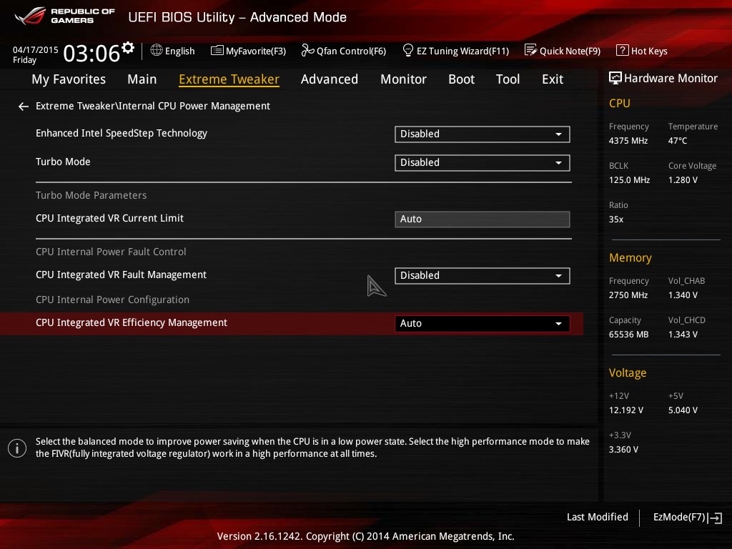

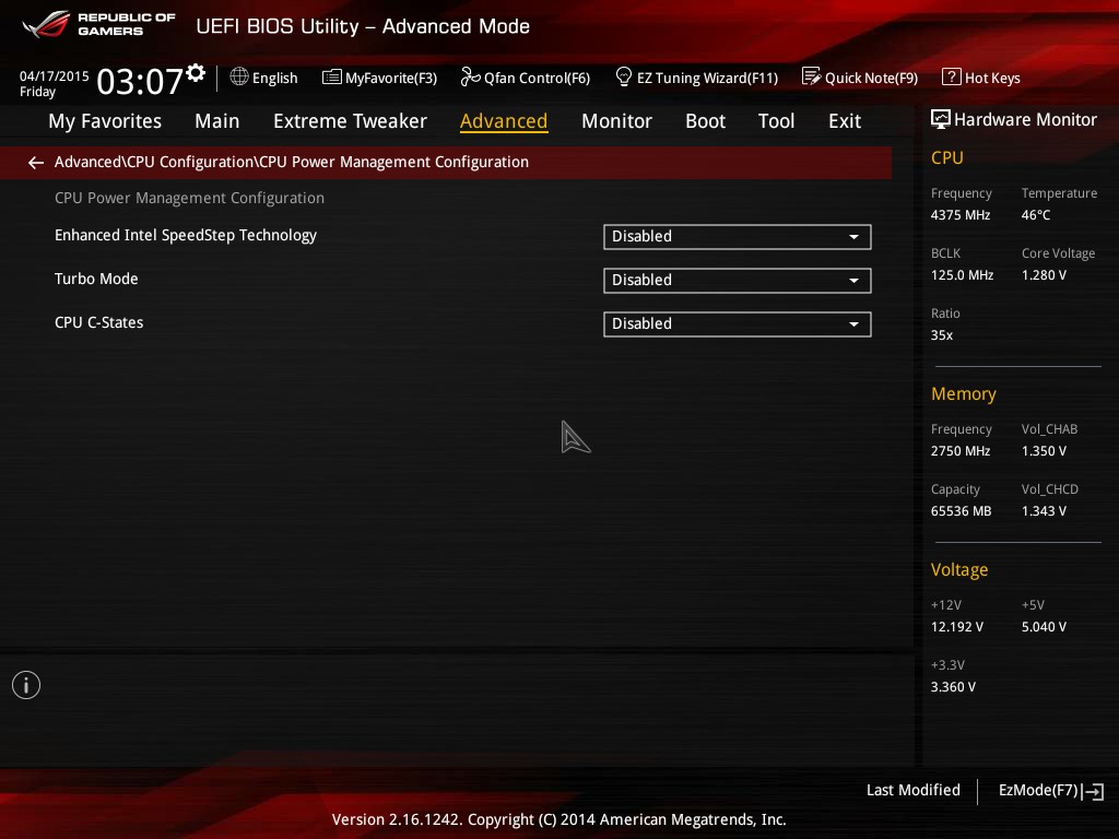

Here are my settings for a Rampage V Extreme with a 5930k. I'm using a two 2800 kits (F4-2800C16Q-32GRK x2). I'm going to try raising the System Agent Voltage to see if I can get this kit to 3000 MHZ as I read adjusting it helps. People are hitting 3000 MHZ at 1.15v or so. At 2750 my RAM timings are a decent 14-14-14-34 2T which isn't bad for 64 GB. If I get it working at 3000 MHZ I'm hoping to run it at 15-15-15-35 2T. No amount of tweaking will get it stable at 1T but I haven't tried adjusting my System Agent voltage yet.
Had to add the last four BIOS screenshots as attachments as there is a limit on the amount of pictures and attachments you can add here. :/
